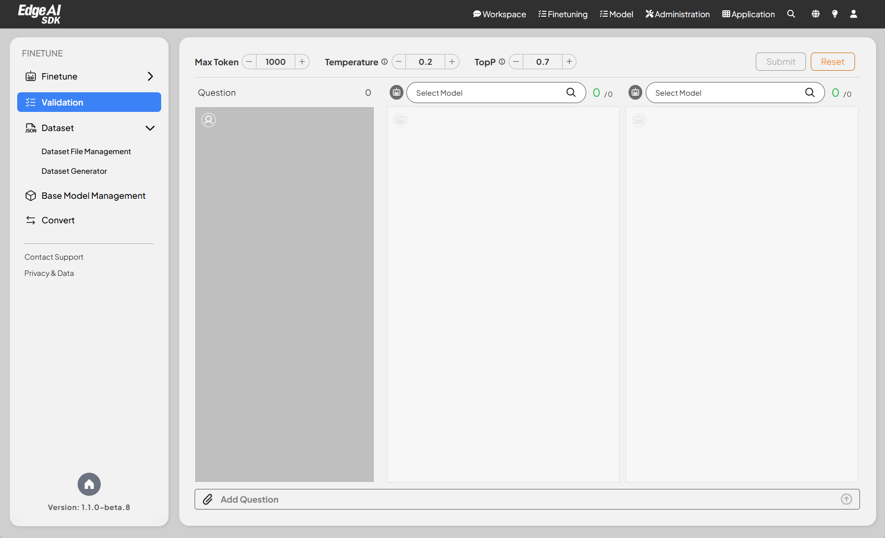

Validation
Configuration Options
  • Max Token: Allows users to set a limit on the maximum number of tokens generated by the model.
  • Temperature: Provides a slider to adjust the randomness of the model's outputs, promoting deterministic or creative responses.
  • TopP: Enables users to fine-tune the sampling technique for better response quality.

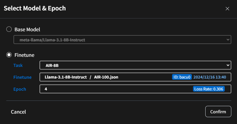

Model Selection
  • Users can select from multiple models available for validation.
  • Clicking on the model list allows you to choose from a variety of available models. These include both pre-trained base models and custom models that have been fine-tuned for specific tasks. Model Selection
  • Example:
    • Foundation Model: meta-llama/Llama-3.1-8B-Instruct
    • After Fine-tuning Model: AIR-8B - Epoch 4.

Question Input Area
  • A dedicated input field for entering questions or prompts to be validated.
  • Users can add questions using the text input area at the bottom of the interface or upload a JSON file to provide a batch of questions.

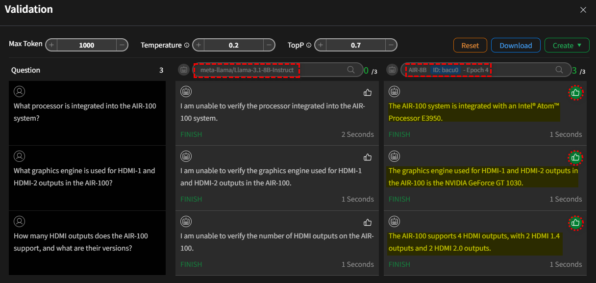

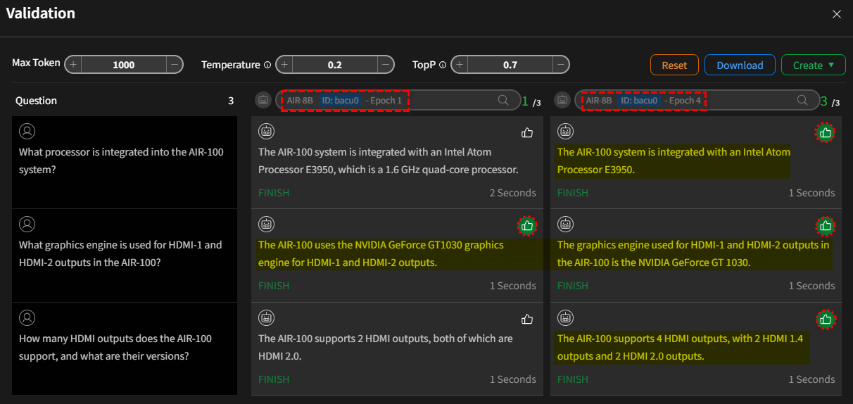

Upon clicking submit, the system will query both models with the provided question. During this process, there will be a brief loading time as the models are loaded onto the GPU. Once the models have generated their responses, a "like" icon will appear next to each answer. If you are satisfied with a particular response, please click the corresponding icon. The system will record the number of "likes" each model receives, which will be used for subsequent model quantification.
  • Case I: Foundation Model vs Fine-tuning Mode (Epoch 4) Validation Case 1
  • Case II: Fine-tuning Mode (Epoch 1) vs Fine-tuning Mode (Epoch 4) Validation Case 2

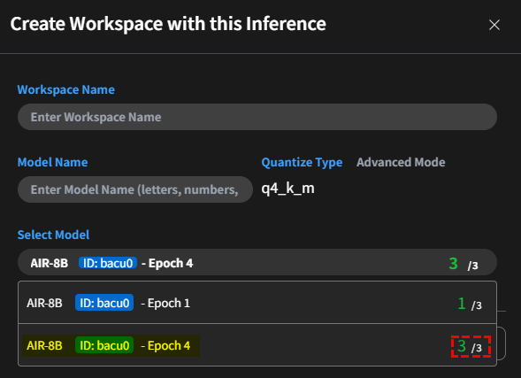

  • Create:
    • Create Workspace with this inference: Quantize the model and create a new Workspace directly, applying the quantized model. The default quantization format is q4_k_m. Advanced quantization options are available in advanced mode. The model selection list will display fine-tuned models from various training epochs. A statistical summary of user ratings for each model's responses will be included to aid in your selection. Create Workspace

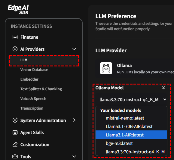

    • Import to Ollama's Inference Repo: To place a model into a repository that Ollama can access and use.
Once the model is compressed, you can locate it in the AI Provider section, under LLM and then Ollama.
Ollama Repo
