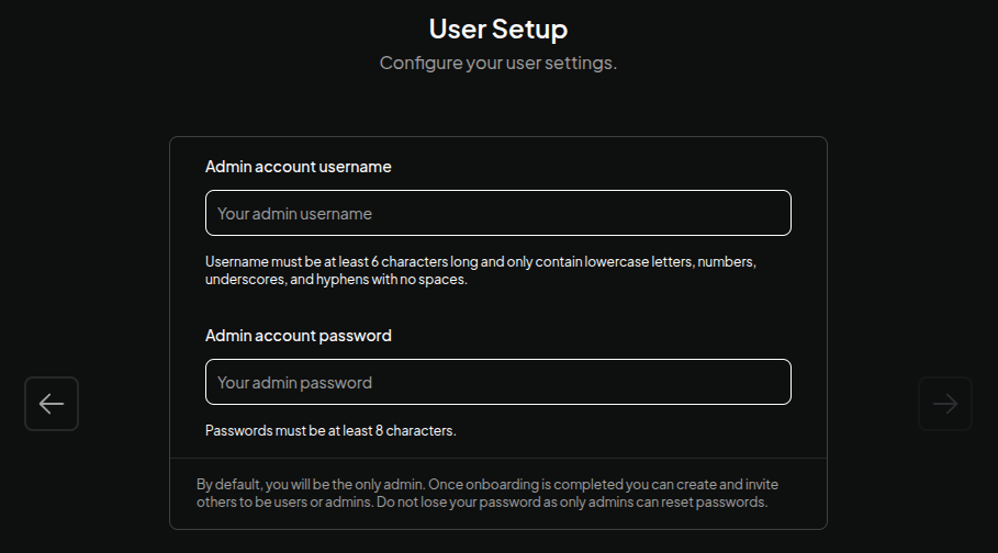

Page - User Setup​
User Setup
  • Administrator Username: Enter the administrator account name for GenAI Studio.
  • Administrator Password: Enter the password.
If the account name and password meet the system requirements, the → button on the right side of the screen will become clickable; click it to proceed to the next page.

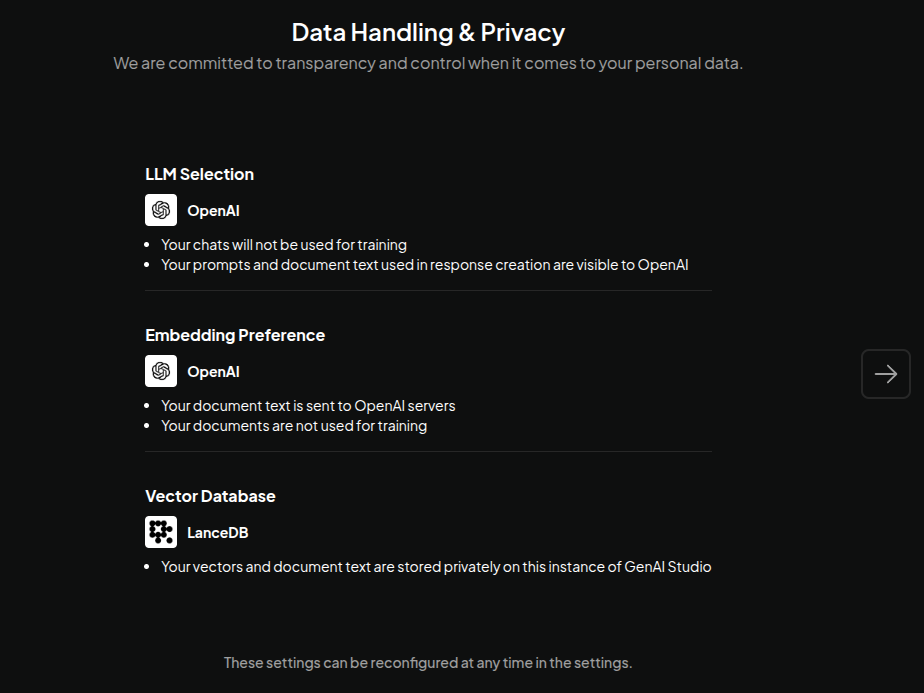

Page - Data Handling & Privacy​
Data Handling
This step simply displays some system messages. No configuration is needed; just directly click the → button on the right side of the screen to proceed to the next page.

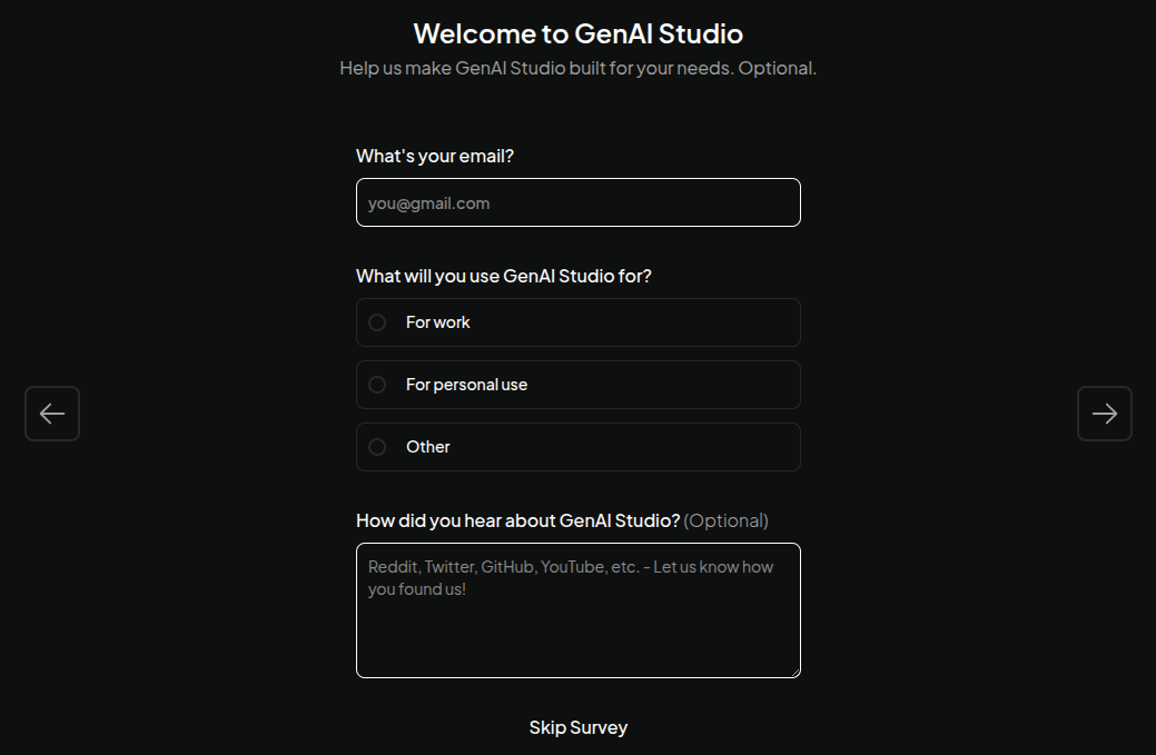

Page - Usage Survey​
Survey
This step is a questionnaire page. Since GenAI Studio will not store or transmit any information from this page, simply click the → button on the right side of the screen or Skip Survey at the bottom of the page to proceed to the next page.

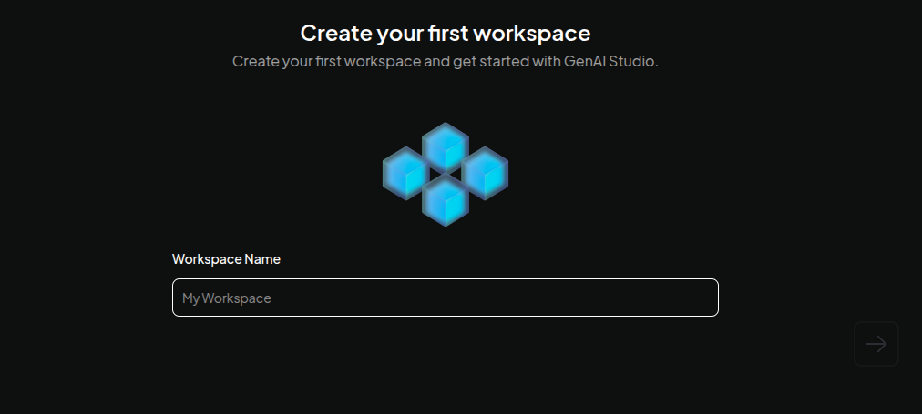

Page - Create Workspace​
Workspace
  • Workspace Name: Enter the name for the first GenAI Studio workspace.
After entering it, click the → button on the right side of the screen to complete all initialization settings. After going through the above steps, you will enter the GenAI Studio landing page. Enjoy your GenAI Studio journey!

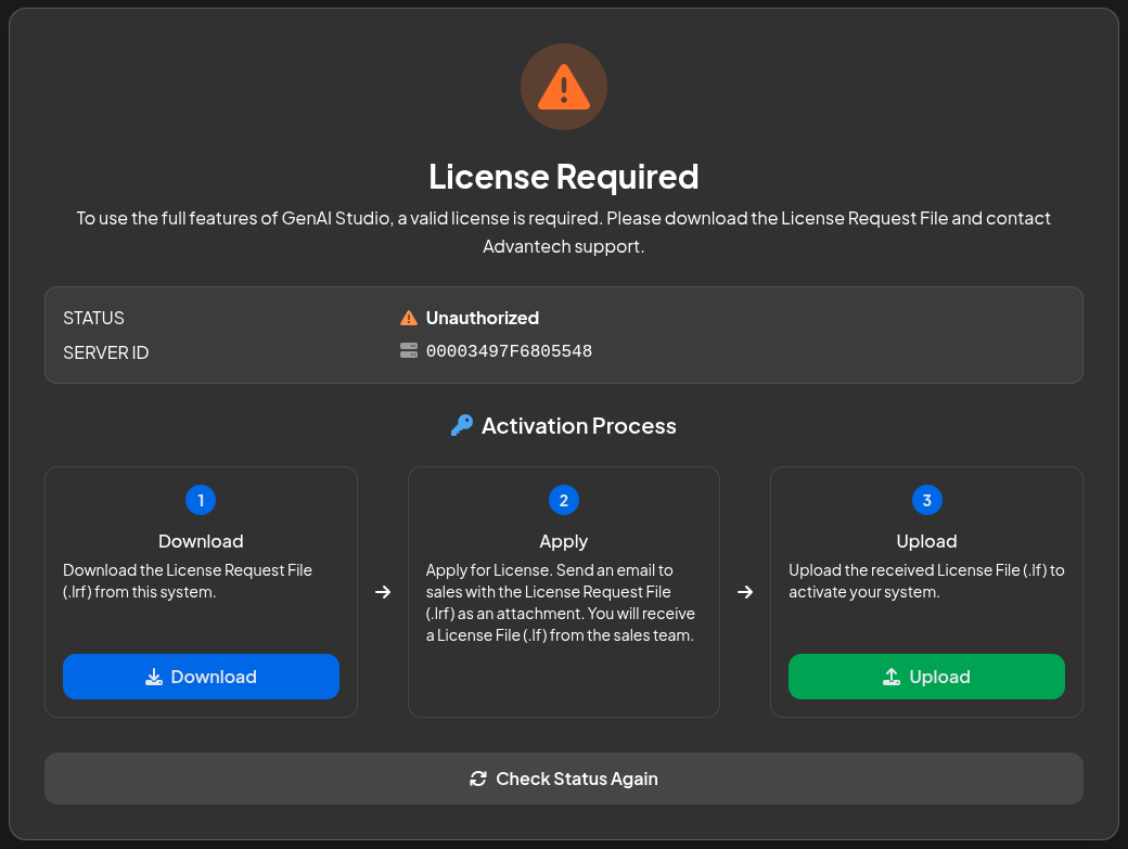

Licensing
Yes, when you see this screen, it means the GenAI Studio installed on your host has not yet acquired a software license. The steps to acquire one are straightforward; just follow the three-step process shown in the image above to acquire a valid license.
Step 1 - Download​
Click the Download button on card ① below to download the specific license request file corresponding to the installation host. If unmodified, the filename should be license_request.lrf.
warning
The content of the license request file is calculated based on the hardware information of the installation host and is deeply bound to that host, so it cannot be used on another host. If you have a second GenAI Studio host, you must apply for it separately.
Step 2 - Apply​
To apply for a software usage license from our company, send the file downloaded in Step 1 as an attachment to aide.support@advantech.com. In addition to the purpose (applying for a software license), please also include the following information in the email to save the application time:
  • Customer Name: Your company name.
  • Contact Name: The applicant's name.
  • Contact Email: The applicant's email address.
  • Contact Phone: The applicant's contact phone number.
  • License Type: Which license type to request? Trial or Permanent.
note
The trial license is valid for 30 days only. After this period expires, you will no longer be able to use GenAI Studio. Therefore, you must either purchase a Permanent license or apply for a new Trial license to continue using the service.

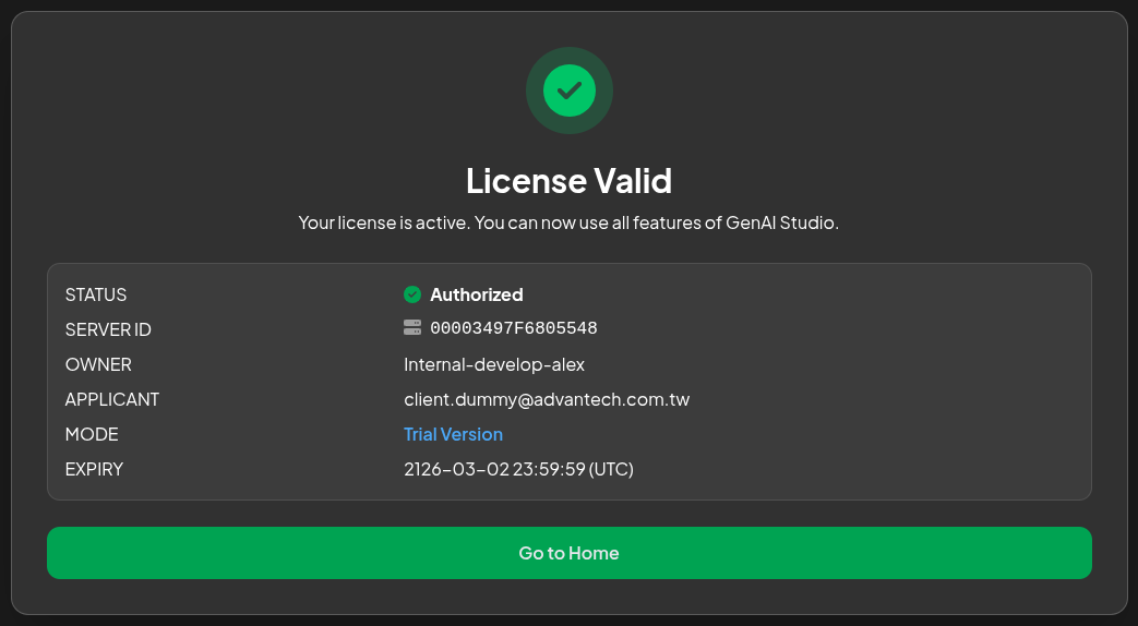

Step 3 - Upload​
After receiving the official software license file (with the .lf extension), click the Upload button on card ③ at the bottom of this screen and select the location of the license file to import it. If everything is correct, the License Valid page will appear, as shown below.
Activated
