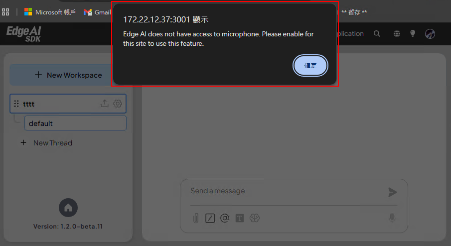

Why can't I use the microphone in the workspace chat interface?
Microphone
As shown in the image above, when you want to use the microphone in the chat room. If you see a message like Cannot access microphone as shown in the image below, this is because Chrome by default only allows HTTPS websites to use the microphone. If you want to allow non-HTTPS websites to use the microphone, you must modify Chrome's default configuration.

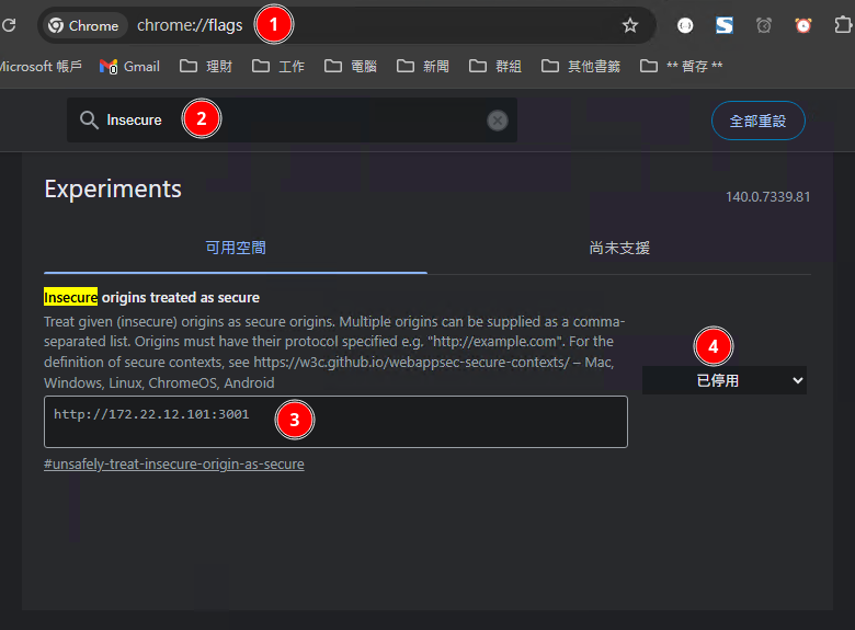

To modify Chrome's configuration, follow these steps:
  1. Enter chrome://flags/ in Chrome's address bar to open the flag settings page.
  2. Enter insecure in the search box to find the Insecure origins treated as secure setting.
  3. Fill in http://hostname-or-ip:3001 in the Insecure origins treated as secure setting field. Where hostname-or-ip is the hostname or IP address of the GenAI Studio host.
  4. Switch the function toggle on the right to Enabled.
  5. Restart Chrome.
Chrome flag
Now you should be able to enable the microphone in GenAI Studio's chat room.
