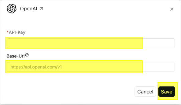

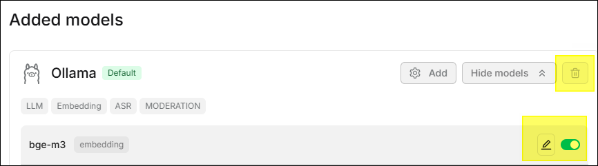

Configure LLM​
As a RAG engine, the application's backend also needs a Large Language Model to act as the brain to provide relevant features.
  1. After entering the application homepage for the first time, click ✚ Create dataset.
    Create Dataset

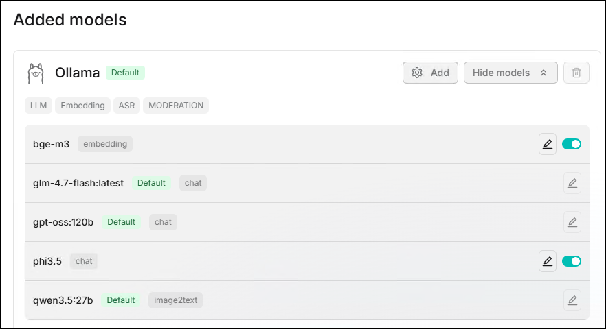

  2. Since the system has not yet configured the LLM and Embedding models, a warning window will automatically pop up. Click the OK button.
    Warning
  3. The system automatically directs to the settings page and synchronizes the models used by Ollama in GenAI Studio.
    Setting

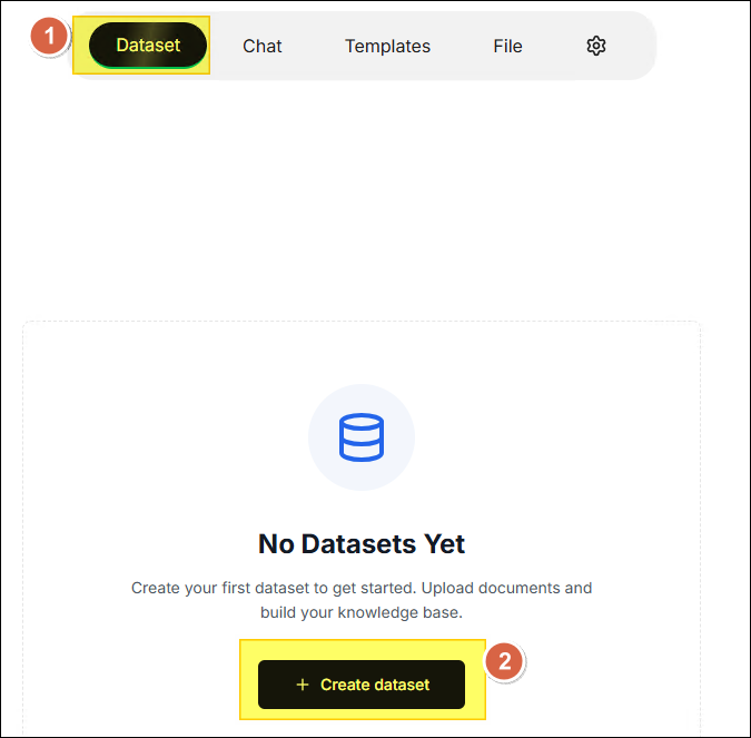

Create the First Dataset​
  1. Click Dataset in the horizontal menu at the top of the page, then click ✚ Create dataset.
    Create Dataset

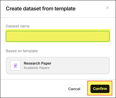

      3. In the Create dataset from template window, enter the Dataset name and click the Confirm button. The page will jump to the Files page.
        Create Dataset

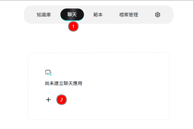

Create the First Chat​
  1. Click Chat in the horizontal menu at the top of the page, then click ✚ on the feature card below.
    Create Dataset
  2. In the opened Create chat window, enter the name you want to use, select the Datasets to be used for the chat app, and click the Save button.
    New Chat
  3. The Chat list will display a feature card corresponding to the newly created chat. Click this card to enter the chat. If necessary, click Chat setting at the bottom left of the page for more detailed settings according to actual needs.
    Chat

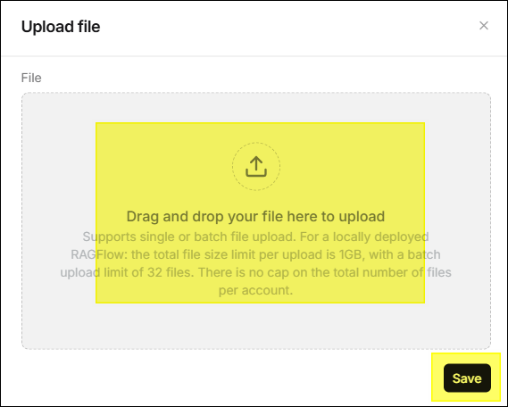

⛭ Upload File ⛭​
Two methods are supported: File Link and File Upload.

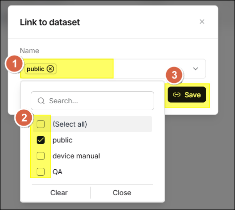

  1. File Link: The file system supports allowing multiple datasets to reference to the same file. In this mode, each dataset only saves a "reference" to the file without repeatedly copying the content. Therefore, when the source file changes, all datasets referencing this file will be updated synchronously. It is suitable for scenarios where multiple datasets need to reference the same file and want to maintain content consistency.
  2. File Upload: Supports uploading files or folders from the local machine to the dataset. After uploading, the system saves a copy in that dataset, which means this file is independent of the original source or files in other datasets and does not affect each other. Even if the original file is modified or deleted, the file content in the current dataset will not change. It is suitable for scenarios requiring data isolation, independent versions, or avoiding mutual influence.

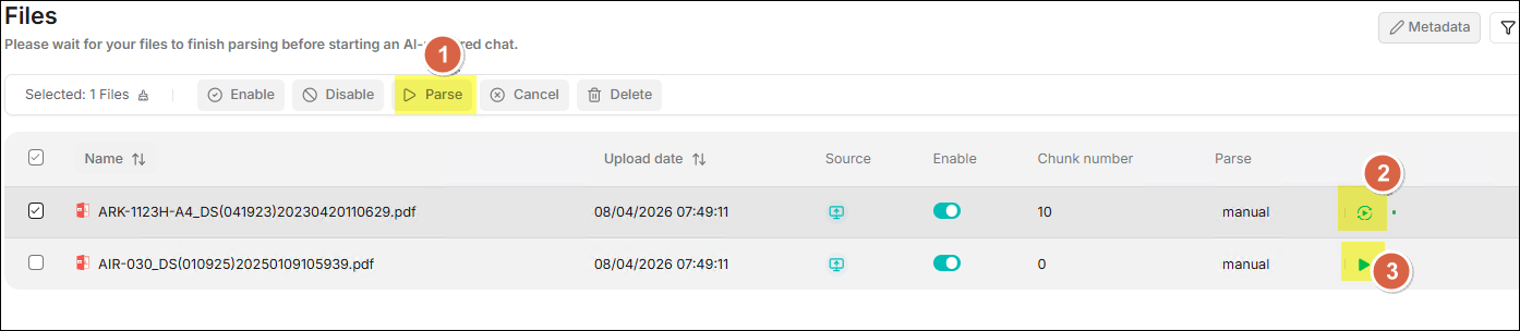

⛭ Parse File ⛭​
guide-files-parsers Provides three methods for parsing files:
  1. Batch Files Parse: Check one or more files, then click the Parse button in the top toolbar to initiate a batch parsing task for the selected files.
  2. Reparse: Click the rotation icon located on the right side of the file to reparse that single file.
  3. Single File Parse: Click the play icon located on the right side of the file to perform the initial parsing for that single file.

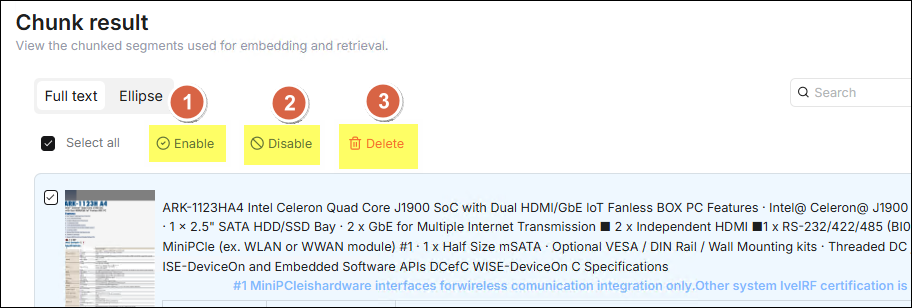

⛭ Chunk Result ⛭​
guide-chunk-result After the chunk parsing is completed, click the document to preview the chunking result of the document and confirm the quality. Check the checkbox on the left of the chunk row you want to operate on to perform relevant operations on the checked chunk data:
  1. Enable: Enable the selected chunks. Enabled chunks will participate in vectorization and retrieval, which is a prerequisite for normal retrieval.
  2. Disable: Disable the selected chunks. Disabled chunks will be excluded from retrieval, suitable for filtering invalid, duplicate, or low-quality chunk content.
  3. Delete: Permanently delete the selected chunks. This operation cannot be undone, please use it with caution.

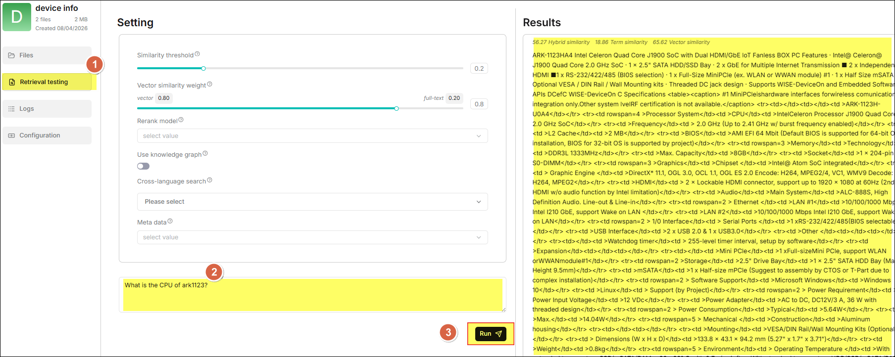

⚙️ Sidebar > Retrieval Testing​
After files are uploaded and parsed, it is recommended to conduct a retrieval test before configuring the chat assistant. In the retrieval testing phase, the system will perform a hybrid search on the generated chunks based on your specified chunking method. The hybrid search combines "Weighted Keyword Similarity" with another type of semantic relevance score, specifically:
  • When no rerank model is selected
    Weighted Keyword Similarity + Weighted Vector Cosine Similarity.
  • When a rerank model is selected
    Weighted Keyword Similarity + Weighted Rerank Score.

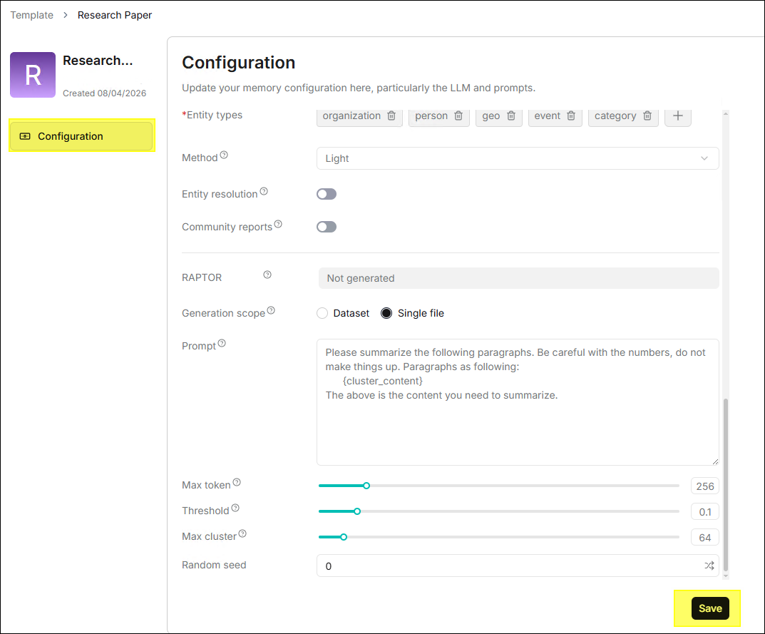

⚙️ Sidebar > Configuration​
Configuration is the most critical setting center of the dataset, directly determining document parsing quality and retrieval effects. It is recommended to complete the configuration before uploading documents for the first time. The parameters for related settings are explained below:
⛭ Basic ⛭​
FieldRequiredDescription
NameYesTemplate name, used for display and retrieval in the template list.
AvatarNoTemplate avatar/icon, for quick identification in the list.
DescriptionNoExplanation of template purpose, recommended to describe applicable document types and target scenarios.
Embedding modelYesThe default embedding model used by this template, affecting vectorization quality and retrieval effects.
Page rankNoPage sorting weight, used to control the display order of templates in the list (higher values are ranked higher).
Tag setsNoA collection of template tags, used for classifying, filtering, and batch managing templates.
⛭ Ingestion pipeline ⛭​
Parse typeYesParsing type, used to specify the implementation of chunking and parsing workflows.
Chunking MethodYesChunking method. Determines how documents are split into retrievable text chunks.
PDF parserNoPDF parser. Used for processing PDF document structure and content extraction.
Auto metadataNoAuto metadata extraction switch. Once enabled, you can enter Settings to configure metadata extraction rules.
Auto-keywordNoParameter for the number or intensity of auto-generated keywords. The higher the value, the more keywords are auto-generated.
Auto-questionNoParameter for the number or intensity of auto-generated questions. The higher the value, the more questions are auto-generated.
Options in the Chunking method field are described as follows:
NameDescriptionSupported File Types
GeneralContinuously chunks files based on the default chunk token count.MD, MDX, DOCX, XLSX, XLS (Excel 97-2003), PPT, PDF, TXT, JPEG, JPG, PNG, TIF, GIF, CSV, JSON, EML, HTML
Q&ARetrieves relevant information and generates answers in response to questions.XLSX, XLS (Excel 97-2003), CSV/TXT
ResumeAn enterprise-exclusive feature, also available to experience on cloud.ragflow.io.DOCX, PDF, TXT
ManualPDF
TableTable mode using TSI technology for highly efficient data parsing.XLSX, XLS (Excel 97-2003), CSV/TXT
PaperPDF
BookDOCX, PDF, TXT
LawsDOCX, PDF, TXT
PresentationPDF, PPTX
OneEach document is a single chunk and is not split.DOCX, XLSX, XLS (Excel 97-2003), PDF, TXT
TagThis dataset is used as a tag set for other datasets.XLSX, CSV/TXT
⛭ Global index ⛭​
Indexing modelYesGlobal index model, used for knowledge graph extraction and index construction.
Knowledge graphNoKnowledge graph generation status. Displays Not generated when not generated.
Entity typesYesEntity type collection, defining target entity categories for extraction, supports Add/Delete.
MethodNoGraph construction method, affecting index construction speed and effect.
Entity resolutionNoEntity disambiguation switch. Merges identically named/synonymous entities to reduce duplicates when enabled.
Community reportsNoCommunity report switch. Generates community-level summaries/analysis results when enabled.
RAPTORNoRAPTOR generation status. Displays Not generated when not generated.
Generation scopeYesGeneration scope, generated by the entire dataset or by a single file.
PromptNoRAPTOR summary prompt template, used to constrain summary content and style.
Max tokenNoMax output tokens for summary generation. The larger the value, the longer the summary can be.
ThresholdNoClustering threshold parameter, affecting clustering granularity.
Max clusterNoUpper limit for max clusters, used to control clustering scale.
Random seedNoRandom seed, used to improve the reproducibility of generation results.

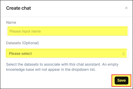

  2. Create Chat: Click the ✚ button to pop up the Create chat dialog box. guide-chat-creation
  3. Fill in Information: Enter the Name and select the Datasets.
  4. Save and Enable: Click Save after completion. The assistant appears in the chat list, click it to start a conversation. guide-chat-window

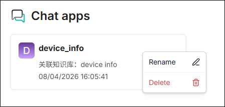

⚙️ Chat Management​
Click the "···" menu on the right side of the chat card to execute the Rename or Delete function.

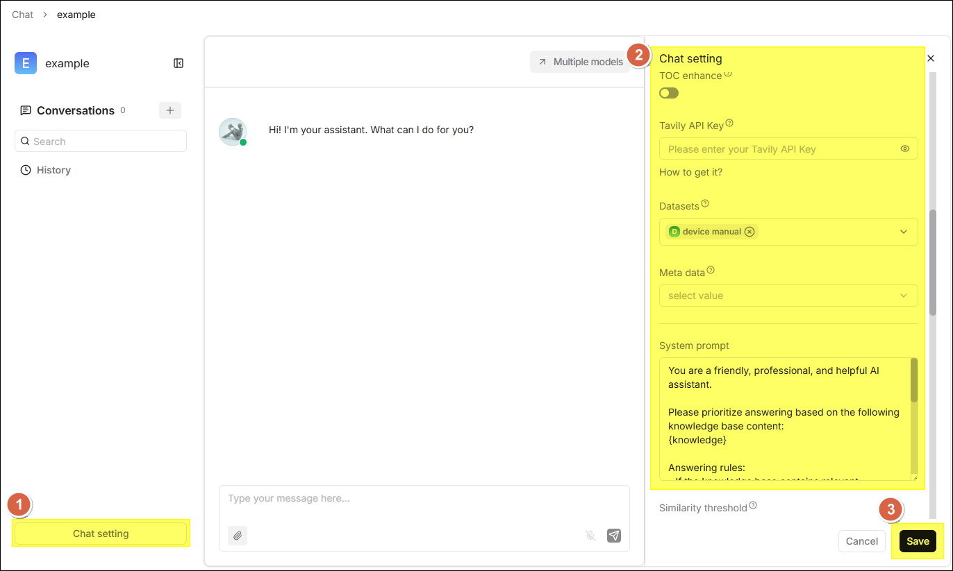

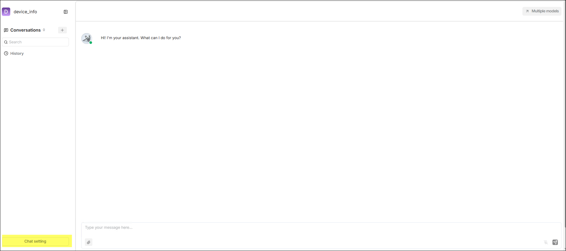

⚙️ Chat Settings​
guide-chat-settings
After clicking the chat card to enter the chat page, you can click Chat setting at the bottom left. Detailed configurations will appear on the right side of the page, where you can adjust the following settings:
